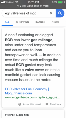

Had similar problem but on an 05 and an 07 without any codes and it was the egr valve. Check and see if throttle body needs to be clean.

I'm here because my 2011 Ram 1500 has 1) take a considerable gas mileage hit (decrease of about 2 MPG), 2) has had idle fluctuations after coming to a stop (typically dips to 350-400 and jumps to 600-700 before resting at 500) for a few months and 3) just died on me after having parking with the steering wheel to turned to the left. This is the first time it has died on me ever. So, what have I done on this truck - well, I've replaced the throttle body, the spark plugs, the coolant, and had all the fluids exchanged. I've checked for hose leaks, haven't found anything. I've got 102K miles on it. I've been reading for possible reasons for my issue and found that it could be the MAP sensor and/or PCV valve - both of which can affect the idle and overall performance - both of which I've been experiencing. Thus I just purchased these two items for a grand total of $51. This truck should be running great and I'm hopeful after replacing these pieces this weekend, I'll have my old truck back! I'll report back about this time next week and let you know the result
