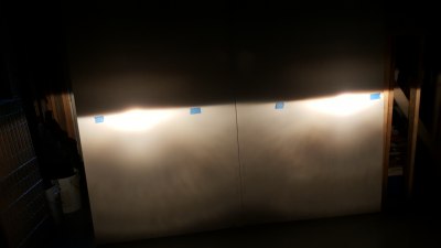

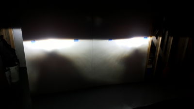

Save some reading.. Hikari Lows and Fogs pictured on page 4
Figured I'd give some LEDs a shot in my projectors and ended up deciding on Hikari Ultra LEDs after reading an impressive review on bulbfacts.com. I also wanted to support a local shop and try their Firewire LEDs. When comparing the 2 mfrs side by side there's no comparison..
Hikari Is impressive. Better fan and cooling design, lower profile and came with drivers. They seated nicely into the housing and are completely clockable.. The base ring can be turned and and if it won't turn enough just twist off and put back on in a new position I clocked one side at 9/3 and the other at 3/9 . Power cord is 6 o'clock. Seemed to make no difference.
The Firewire LEDs came off as flimsy, poor cooling design, crazy size and did not seat well into the housing.. Felt loose. The fire wires were so big that I couldn't even get them into the high beam socket. Tried them. In the low and they wouldn't even power on. Wouldn't power on in the fogs either. On top of that.. They cost more! I really wanted to support locally but considering these factors, they'll be going back and I'll order a set set of of another brand off Amazon. Gotta read up first on reflector style reviews.
Below are some pics.. You'll figure them out. A before shot, Some are comparison shots, one of side by side of halogen VS led and then some road shots. A few with or without halogen fogs on.. You'll be able to tell. You'll notice that when the led lights are shined onto drywall that there is a dark void on the bottom side but the upper cut off is crisp. The void isn't super noticeable on the road and it I'll improve with proper fogs I didn't have to adjust anything. The best test will be driving to work in the morning.. Dark highway cruise. I'll be back with some shots tomorrow and in another few days with additional led highs and fogs.

Thanks for the update, and for tomorrow's as well after your real world test drive. I'm tempted to go with the Hikari's for the lows and highs in my projectors. Cant remember if you've ever had hid's before in the projector, but if so, how do these compare? They certainly look bright enough.

I sir, am no expert on auto lighting haha. I've never had HIDs before and just like alot of guys, I'm trying to find simple solution. Would HIDs be brighter? I'm gonna say yes but I don't need all the headaches. I didn't get high beamed once on the way to work this morning but I don't have LED fogs yet.
As for you gf car.. Look at bulbfacts.com and find what's best in the type of headlight she has (reflector or projector) , high, low and fogs are rated for each bulb as well. And then there are 6 tiers of price range.. If you don't mind spending a hundy on the gf car, ddm and Hikari are impressive reviews for reflector headlights. Take note that the ddms are not clock able tho. They make it pretty simple to decide and they have no loyalties towards any one brand. And neither do I so I'll probably just grab a set Nineo Gen II 9005 for my highs and Save a few bucks but stick with Hikari 9006 for fogs. I may slip one of the Nineo bulbs in the low beam side and see how it compares to the Hikari...
If you do go with Hikari, remember to enter the code to save 10% . It's BULBFACT

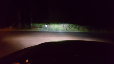

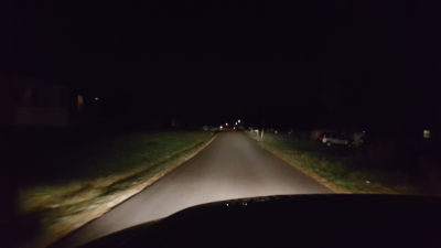

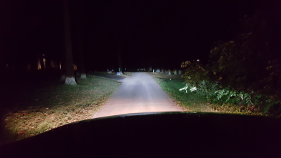

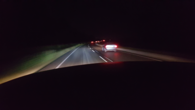

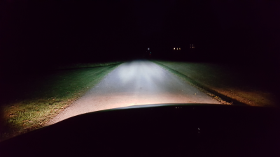

Yesterday VS Today on highway. Had a little fog yesterday. One thing I'm noticing in the before pics is just how much work the fogs are doing. Can't wait to get some good bulbs in there!

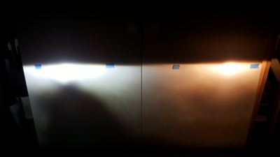

In terms of the blackout area for the hikari's in the projectors, do you think the fog lights make up for most of that blackout area? I didn't notice it too much in the pictures of it on the road but it was pretty clear against the drywall, I'm wondering what the drywall would look like with the hikari's in the projectors and with the fog lights on? It's definitely tempting, I've never had Hid's hold up too long whether it was a cheap kit or more expensive, and I hate having reliability issues with headlights. So I would sacrifice a little in performance to hopefully gain long term reliability.
I would love to find one brand LED to use to switch both of our lows/highs out with, don't mind spending a little more to do that with higher quality product at all so I may just go this route. And thanks for that discount code as well!
Thanks again for the good information, I'll have to check out their website in regards to the gf's car. In terms of the blackout area for the hikari's in the projectors, do you think the fog lights make up for most of that blackout area? I didn't notice it too much in the pictures of it on the road but it was pretty clear against the drywall, I'm wondering what the drywall would look like with the hikari's in the projectors and with the fog lights on? It's definitely temptingQUOTE]
Thanks again for the good information, I'll have to check out their website in regards to the gf's car. In terms of the blackout area for the hikari's in the projectors, do you think the fog lights make up for most of that blackout area? I didn't notice it too much in the pictures of it on the road but it was pretty clear against the drywall, I'm wondering what the drywall would look like with the hikari's in the projectors and with the fog lights on?!
Thanks again for the good information, I'll have to check out their website in regards to the gf's car. In terms of the blackout area for the hikari's in the projectors, do you think the fog lights make up for most of that blackout area? I didn't notice it too much in the pictures of it on the road but it was pretty clear against the drywall, I'm wondering what the drywall would look like with the hikari's in the projectors and with the fog lights on? It's definitely tempting, I've never had Hid's hold up too long whether it was a cheap kit or more expensive, and I hate having reliability issues with headlights. So I would sacrifice a little in performance to hopefully gain long term reliability.
The dark spots are probably more pronounced on the drywall because I was only maybe 8' away. I don't really notice while driving but adding Leds to the fogs is really going to light it up good in front of the bumper. My fogs will be here tomorrow and my highs on Friday.
Yeah I'm sure adding the fogs will make a big difference as well. I'm currently running the stock halogens in the projectors with led in the fogs (from my last truck, had hids in those projectors but they were starting to have issues so I traded those with the truck) and the led fogs are far more effective than my headlights. Seems like they do most of the lighting themselves.
