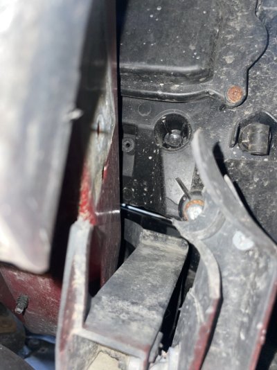

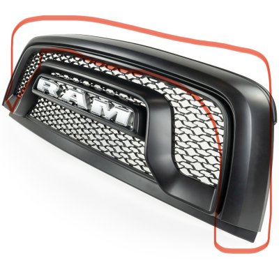

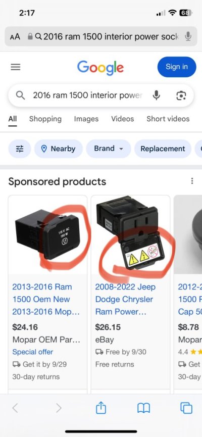

IMG_4291.jpegHello, I just purchased a 2016 Rebel a few days ago. It has been very nice to drive and I like it so far. I do have a few questions I hope you guys could answer. Since the truck is now about 10 years old it is missing some things or they are damaged and need to be replaced. I will attached images of the things that I am referring to. First is the HID headlight holder on the passenger side, it is broken and does not hold the headlight properly. Do you guys by chance have a link to the part to replace it? Second is with the interior household style power inverter outlet, mine is missing the cover, does anybody have the link for that also? The third thing is with the rear passenger turn signal. My truck on startup tells me the bulb is out but I can see it flashing in the mirror, I did see that there is one of the LED bulbs (I assume) out on that taillight in the upper section. Does the whole assembly need to be replaced? Fourth has to do with the grille, specifically the upper section of it. Mine is cracked and needs to be replaced. I had the grille off already and it seems like that piece can be unscrewed and replaced without having to replace the whole grille. The final is about the power folding mirrors. My left one doesn’t work and the right folds in but doesn’t like to unfold without being pushed a bit. Anybody have a solution to that? Thanks in advance

View from passenger fender well to back of headlight

I can help you with at least 1 answer. To my knowledge, the power inverter is sold as a unit, it you want the cover, I don't see it listed separately on any mopar site. When mine was damaged, I ended up purchasing the entire unit new it's about 25 buck from mopar direct before shipping.
