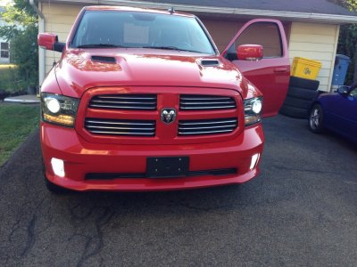

I played with the clocking and right now they are diagonal (opposing angles on each side) I had to run into town and didn't get high beamed. I DID HAVE RADIO INTERFERENCE WITH FOGS. I still have the Hikari filters I bought from Amazon so I'll try that.
With fogs and without.. And a highway shot
