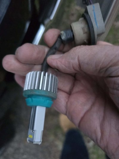

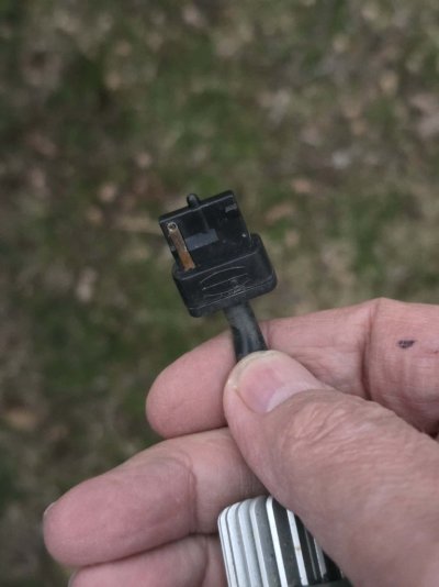

OK I got curious, and I've been meaning to chase this down for a while anyway, so here are some pics. Apparently I got a pack of Auxito 194 because I still have the extras. Also, my reverse setup looks like your description of yours. They've been in since July 2023 so they've been holding up pretty good. I have not had to replace any rear light bulbs since going to LED.
^These are the 194, can't recall where I used them, license plate maybe? You can see the base is very small compared to the reverse LEDs I used.
Below are the reverse LEDs. Note the similar but much larger base...

That's what I was wondering about, the OEM plug being outside of the housing, exposed to the weather. But if you're in PA, with the salty roads, I'm hoping that shouldn't be a problem for me. And for my high mount/3rd brake light, I have the Morimoto one
Yup, but as you can see the OEM bulb is exposed the same way. The LED has a "pigtail" about 6" long, but the OEM harness connects to the OEM bulb outside the enclosure, as do the brake lights and the front fog lights.
EDIT: Your Morimoto looks nice. I thought I'd start with bulbs and go from there, but the reverse was most desperately in need of upgrade and the LED made the greatest difference there.
The license and cargo lamps are brighter white but don't produce a huge difference, same with the 3rd brake light. It's just a bit more intense but not significantly so.
