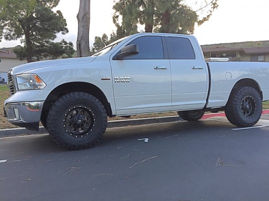

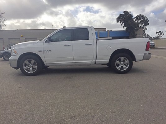

Heres my contribution
Note: I turned up the brightness on the photos so that you can better see the wheel gap.
Stock
Bils at 2.8 with 3/4" rear TGC poly spacer
17x9 Fuel Revolvers 0mm offset/5" backspacing, 35x12.50 nitto trail grapplers. (Rub at full lock, reverse only)

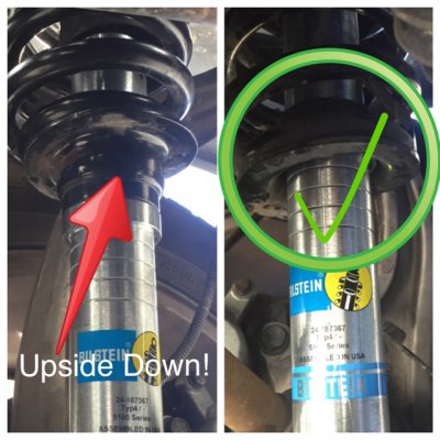

And here's my install tip:
Part numbers for Bilstiens:
Front 24-187367
Rear 24-187374

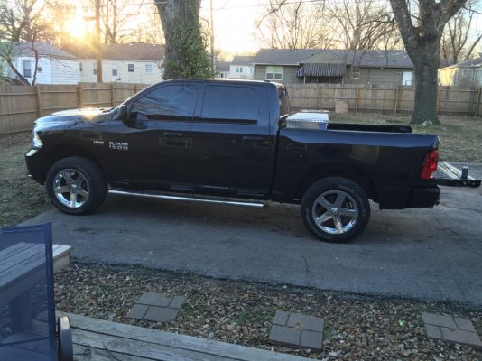

chipmaker
Dec 21, 2011
307
116
AZ
Bils @ 2.1"
Mastercraft 35 x 12.5 x 20 tires
No wheel spacers
No Mevotechs
12k miles on Bils and tires
No issues
