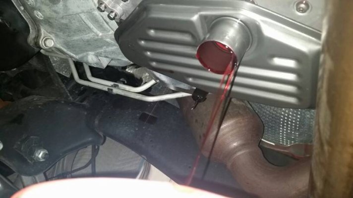

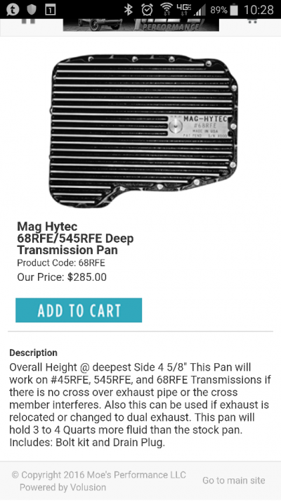

I just purchased (12-28-2016 ) a MAG-HYTEC 45RFE XSMN Pan today .
This pan has many featurs that the OEM pan does not.
1) First and for most it has a Drain Plug !
I Do Not understand why a drain plug is not standard ?
This drain plug has a very strong Magnet on it , so when you drain the fluid you can clean the captured ferrous debris , what a great idea !
2) This pan has a +1.5 to +2 Qt. Capacity of fluid over the OEM pan , this extra capacity aids in the cooling of the xsmn , this is great for people who tow , especially in the summer .
3) Speaking of cooling the xsmn, this pan also has a large amount of Cooling Fins , now that's just a good idea !
4) The wall thickness and the Mounting Flanges are much thicker than the OEM pan , this is great for you 4 wheeling enthusiasts & Rock climbers , also Aids in disipating HEAT as well !
5) Lastly this pan just looks cool pun intended! Get it ? Looks cool and it has many fluid cooling characteristics anyway here's a picture .
Notice the giant step in the pan , this is to clear your stock exhaust system . If you have a non oem exhaust that doesn't interfere with this area then for a +2 more qt fluid capacity you can install the 68RFE DEEP Pan that looks like this .

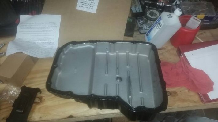

This pan is for the 65RFE 6 speed xsmn with stock exhaust.

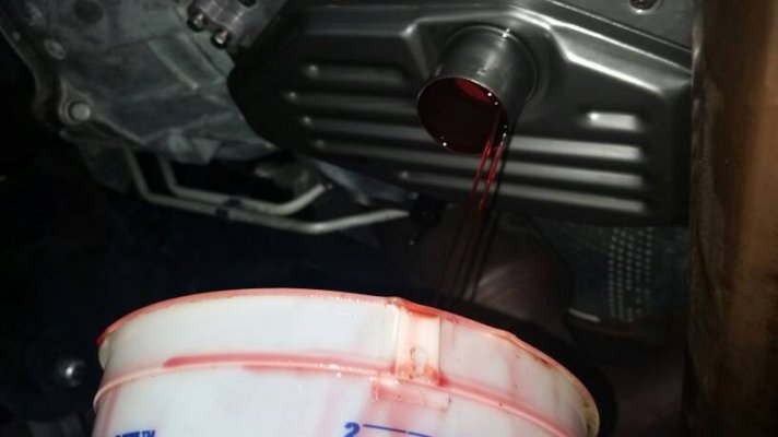

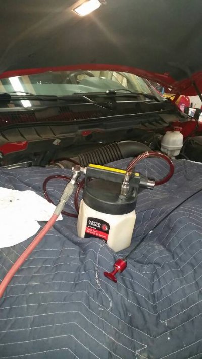

First I vacume pumped out all the fluid with a Matco break bleeder to prevent a giant mess while dropping the pan
Had to stop & dump 3 times ( took 10 mins max) very much worth it imo .
I got out about 6.5 qts ! A bit more than I expected .

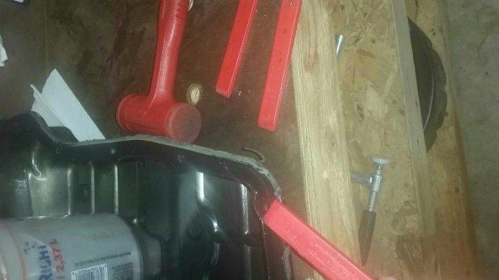

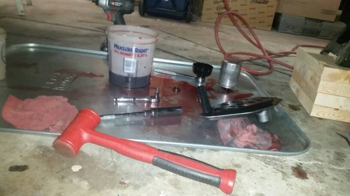

Next I removed the OEM pan .
Pretty straight forward here . Remove the bolts (5/16" / 8mm )
☆☆ leave in 3 to 4 mostly loose so the pan doesn't fall ☆☆
then utilize a HARD plastic wedge/ scraper and small hammer to get a corner started .
This pic is complements of U&A
I used a much smaller plastic scraper.
Now just Remove the remaining bolts and navigate the pan down avoiding the exhaust pipe .

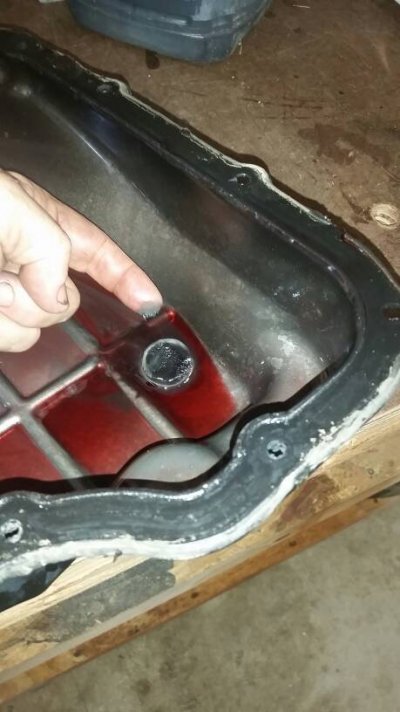

My OEM pan had a rubber gasket and it had been installed with a sealant as well .

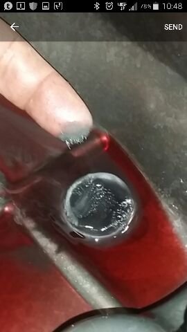

My OEM PAN magnet had very little ferous debris on it for 47,000 miles IMO & with a decent amount of towing and a few tows that I wish I had never done

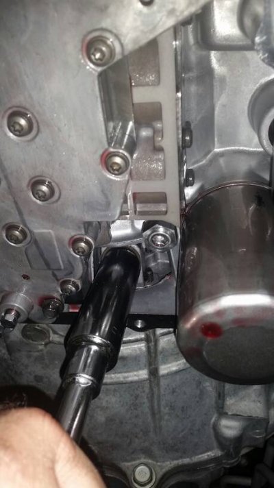

Next I removed the spin on filter . I used a filter wrench from my motorcycle. It's made by Ampro , #s on it are 65/67 with a 14 beneath.
☆☆☆Caution ☆☆☆
Before breaking the tq on the spin on filter MAKE SURE you have a small container beneath the sump inlet tube ! ! Removal of the spin on filter opens a vent for trapped fluid and it gushes out of the sump filter in a hurry approx 3/4 qt !
Then I installed the new spin on filter. P/N see pic below ☆☆☆☆ as Hemi395 said ☆☆☆☆☆in his xsmn filter replacement " the spin on filter has plastic threads and is VERY VERY easy to crossthread ! " I recommend practicing with the old filter to get a good feel for it !

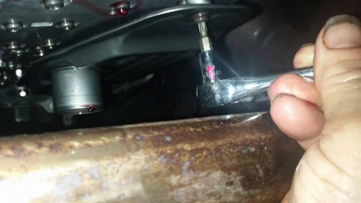

Next I removed the sump filter , one screw only holds it up in place ( T-25 bit )
Once the sump filter is removed , then remove the sump filter seal .
I used a 90° scribe, be careful to only get the seal & not score the seals mounting surface .
I then intalled the new seal ( which comes with the filter ) first by hand just enough for it to stay in place , then light taps with a small hammer and a 3/4 socket & extention.
Next I installed my new sump filter

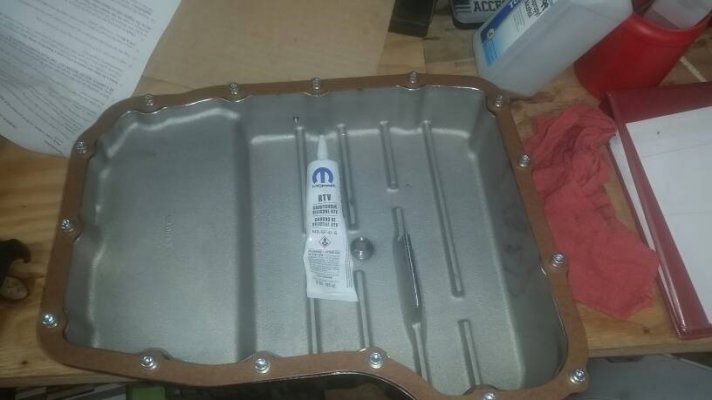

Now for the Mag-Hytec pan install .
A couple notes here :
1) ensure to perform a dry run (practice ) so to speak on the pan install , this will let you know what to expect for the real install .
2) the pan is a bit heavier than I thought , remember your holding it with one hand and with the other getting harware in place and such .
3) in my case I found there to be a significant amount of tare torque on the provided new zinc hardware ( aprox 35 inch pounds ) Prior to the hardware being seated with the new pan during my (dry / practice install with no sealant or gasket )
this tare tq Must be applied to the recommended tq value of 105" lbs . My final tq ended up being 140" lbs .

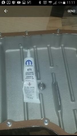

First I cleaned the mounting surface of the xsmn with 99% isopropyl alcohol (acetone would work fine )
Then I cleaned the new pans mounting surface .
I used the Mag-Hytec provided FIBER gasket ( as Hemi395 did with no leaks !)
I put a SMALL amount of Mopar sealant on the pan .
Then I put the gasket on the pan utilizing the Mag-Hytec hardware to aid in alignment .
I pressed firm and evanly on the gasket and wiped away excess sealant .
☆☆☆☆☆Work quickly as this mopar sealant cures quickly ! ☆☆☆☆☆

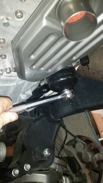

Now under the truck I cleaned the xsmns mounting surface again with the 99% isopropyl.
Then as in my dry / practice fit I put the pan in place and started 4 ea new 5mm Allen head bolts not all the way , just enough to hold the pan in place while you start the other 346 bolts
I highly recommend a 5mm "T" handle Allen wrench for this ! If you have MAN HANDS like me ....

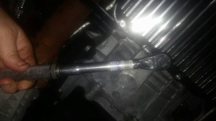

Now just evenly snug down a couple times around with the HIGHLY RECOMMEND T handle .
The Recommended tq per Mag-Hytec is 105" lbs + tare (for my xsmn) 35 " lbs . Final tq for my situation is 140" lbs .
I do this similar type of work daily , here's the method I used .
First I tqed everything to 60"lbs in a cross sided motion to aid in an even tq and seating of the pan , I continued to use 60" lbs Untill the tq has stabilized.
I then increased the tq in 20" lb increments using the same method above Untill ALL tqs have stabilized at 140" lbs , then go all the way around hitting each bolt to verify that one wast missed ....this takes a while , I went around probably 10 times . Time consuming but seated very well.
I highly recommend using a tq wrench for this , the sealant squeez out and compression of the fiber gasket is plenty enough to cause a loss of tq.
Next I let the sealant cure overnight ( not necessary ) but I had the time , besides I had steaks to grill , beer to drink and a pretty little women to tend to
Next morning I tq checked all the bolts @ 140" lbs = zero movement .
I plan on tq checking again after a drive up to operating temp . Make sure it has cooled to the touch ! Do not tq while still hot !.

I HIGHLY RECOMMEND TQ CHECKING once COOL like the next morning after a good test drive .
Each one of my 5mm Allen head zinc coated bolts moved significantly ( AS EXPECTED ) I'd say 1 to 1&1/2 Flats of the Allen hex .

.............. I was using the Dorman replacement pan for the 66&68rfe trans but have found some info on it that it may be pushing slightly sideways on the pump filter .............
Got any more info or a link on that Dorman pan pushing on the filter?
I found several reviews stating this is the case. When I put the pan on I had some trouble getting the bolts holes to line up after I got the first bolt in. I had to push the pan slightly towards the drivers side to get them to line up so I could get a second bolt started. After that the all went fine. I figured it was just hitting up against the dipstick because I had forgot to take it out before installing the pan. Just makes me nervous as the main screen filter only has a plastic neck that goes up into the pump.
I'll know more on Saturday when I swap back to the oem pan...
@R.L.K. torque specs for the pan bolts and main filter torx bolt are 105 In/lbs
