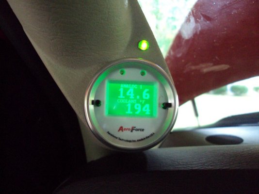

kristin, maybe take a look at a wideband gage so you know what's happening with you fuel mixture. Or possibly a AeroForce gage to cover trans temp, knock, trims and a bunch more. Occassionally you can catch one at a good price. There are others but I haven't used them.
