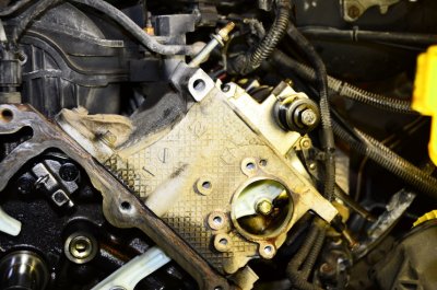

Also, I'm so unfamiliar with the specifics of the 4.7's architecture, I was unable to identify the actual part that broke in the "self-explanatory" pics you posted, in your #17 post. Is that a cam "hold-down"/journal-end, some sort of "rocker," or...?
And, as was suggested, did a machine shop (apparently) weld it up? It looked like a small enough part that I would have thought replacement would have been cheaper--obviously, it wasn't, but I'm just curious here, as I'm trying to learn as much about the 4.7 before I decide whether or not to take the plunge.

The "self explanatory" pictures are of the driver side engine head. See attached picture. It is the mount for the upper timing chain rail.
To replace that would be replacing the entire head. This was free (my uncle is a machinist)
