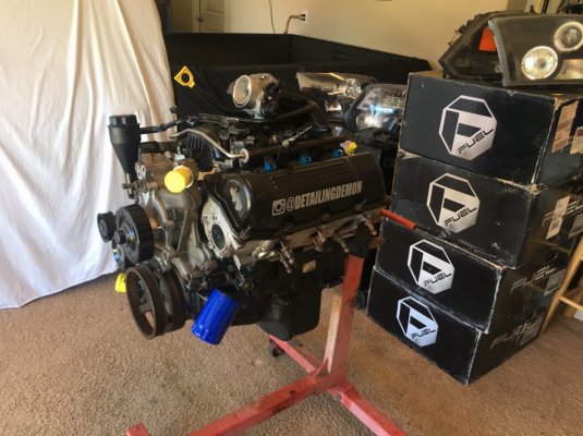

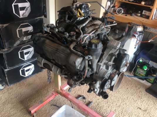

And then the fun began, full teardown, new gaskets, complete going through, all new sensors and a deep cleaning!
New water pump was installed as well
Pretty much i went throughout this moto with a fine tooth comb, checked the rods, bearings, valves, you name it i checked it, i replaced the intake manifold, the throttle body, all the tensioner and idler pulleys, i was making sure there was nothing about this motor that was going to fail
Here it was all complete, i degreased this thing from too to bottom, cleaning everything i could, and made this thing look like bran new, also did an oil change and new filter at the time too

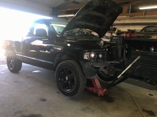

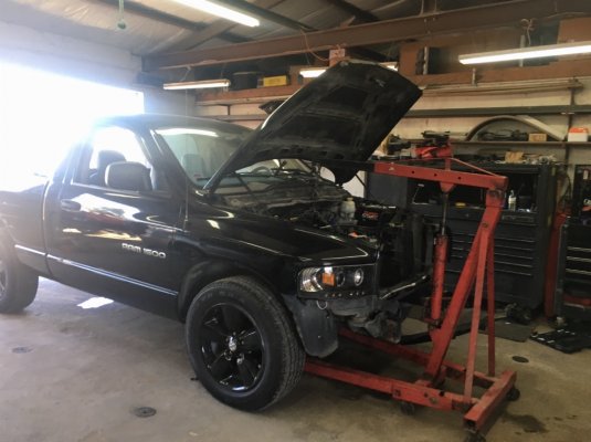

So the day came for the next motor swap, i prepped the truck a d waited on my buddy to show up with our car hauler so we could once again take it to our shop and do a swap on her
I couldnt pass up the chance to take this pic, i rolled the truck out of the garage and into the street so we could load it up and I finally got a chance to see the result of my polishing on my truck and its 14 year old paint in the sun

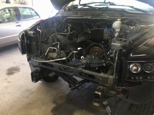

Just some pix from the swap...
The 04 V6 is out
And in went the freshly redone 03 v6

so one would think, the motor goes in and all is well right?
well wrong, we got the motor seated down and all in place, everything all hooked up, and then no matter what we did the transmission wouldn't slip into place, nothing we did would work, had us completely stumped, and frustrated so we removed the trans and decided to try and see if the motor would even run, if it did we could tackle the trans then, so we hook up the starter to the motor and let the truck prime and then give it a start...
and nothing, apparently these trucks will not start without a transmission in them, but that wound up being a blessing because the fuel rail was cracked and spraying gas everywhere under the hood so we were both thankful that it didnt start up

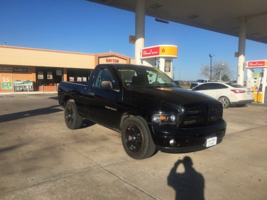

So we basically get it all together, purge the coolant of air bubbles and take her on her maiden voyage, to the gas station lol, i filled the tank with premium and we cruised back to the shop, and this thing drove beautifully, and on this trip i even found out theba/c system worked amazing too!

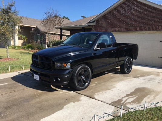

Now before she was reunited with her parking spot in the garage, she got herself a much needed bath and waxing!

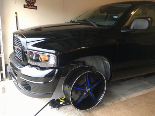

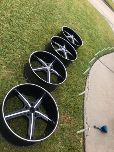

She has spent her time in the garage since she got home due to family events going on, work and bad weather, right now im waiting on the rain to stop so i can get her out...

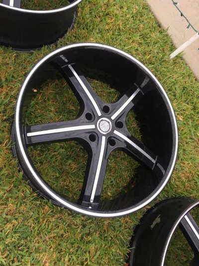

While i love my black 2014 20s i bought my friends black and silver 24s for he truck, im not 100% on what wheel and tire combo ill run but the deal he gave me on these i couldnt pass up!
Anyways here are the wheels...
Yes i know a centercap is missing in the pic but i got 5 wheels and 5 caps, just didnt have it on in the pix...
Now he had the wheels with some blue vinyl over the silver and a texans logo on them but i removed all that crap, but i had to do a test fit first lol...
