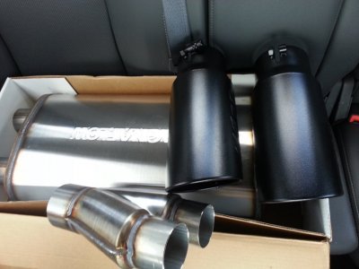

Eric do you have a pic of the tips on your truck you could post?

I am a bit embarrassed of my bumper as I suffered an unseen hit and run at wal mart in February. Let me see if I can find my picture....The tips are black by the way

Here is a picture of them off the truck, I know not what you asked for. I have a short video off a startup where you can see the tips. Let me try and get that posted up for you
