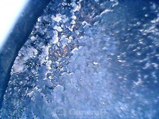

This guy used amsoil PI and tw-c3 in his hemi and this was what he pistons looked after...

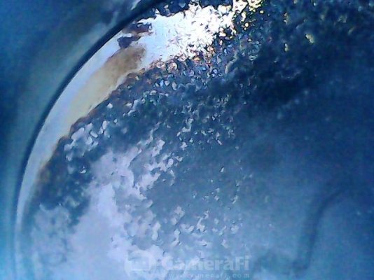

Then he put in one bottle of Redline si-1...
Here's the thread at Bob's, more video's. I only care about results personally, not brand, this one seams to work. I encourage someone to get a 20 dollar boroscope like @Hemi395 did. Challenge these results. That was what he did, he was challenging the results from the video's, as it turns out the results are verified, that redline si-1 works. Seams to take two bottles, that has been consensus with 3 tests so far. Hemi395 is in the middle of this test, he will be posting results soon.
