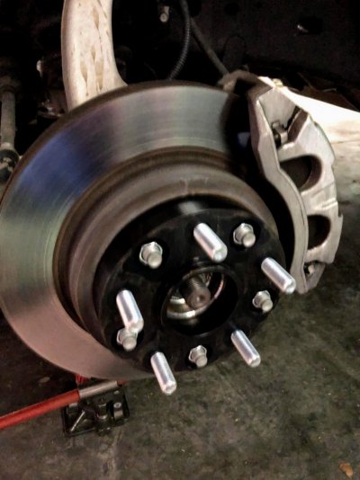

Bora .25 Hubcentric Spacers. Best on the Market.
I ran their 1.25" spacers and did not have to trim any stud. The factory wheels have recesses in them that allow the excess to protrude be fine.
Here is Factory wheels with 1.25" spacers
Thanks for the recommendation and the info re. the factory wheel spaces. I didn't want to mess with the studs so I just assumed I'd use a .25" slip on, but .75" would get me pretty much level with the fenders. I'll check them out, thanks again!
