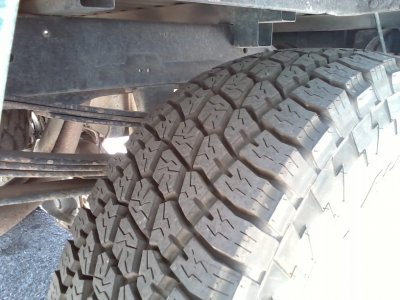

I run E load rated tires on my 1500 all the time. I do lots of hunting and fishing and light duty tires do not take the punishment of hard off-road travel. I have never had a flat or any kind of tire failure since I started using 10 ply tires. My pickup weighs about 5800lbs with my shell and stuff I carry all the time. Right now I have a set of NITTO terra grapplers in 285/75/16 and the sweet spot when unloaded is 40psi. It gives me a pretty smooth ride since I don't expect my truck to ride like a caddy. When I tow my 7500lb travel trailer I fill them up to 60psi.http://www.ramforum.com/attachment.php?attachmentid=89233&stc=1&d=1498404021
