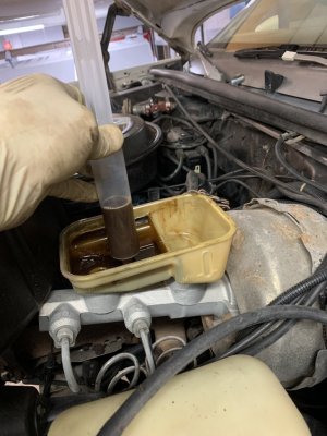

Brake fluid is hygroscopic meaning it retains water. Wearing out and rusting brake systems. Fluid is clear go look at yours and see if it’s brown, then read up on it. It’s pretty interesting I used to not change brake fluid either.
Calipers will last a lot longer, your brakes will feel better, other people on the road will be safer, etc.
that being said I have never in my life had a shop try to upsell me a brake fluid flush

Like I said read about it. There’s more than hygroscopic properties

@gypsy400 here ya go guaranteed this was never opened. The mater cylinder was relatively new it’s overlooked by many, most places don’t want to do it with abs systems etc. just like the places changing tranny fluid but not the filter because they don’t want to cause problems it didn’t come in with41F97FA9-1097-4616-82B9-3FE035E0C8CF.jpegF652FBE5-821A-41D5-9576-F68C94790C4F.jpeg

Wow, thats unreal!
