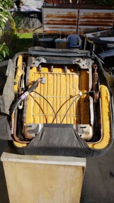

Anyway, the the removal, stripping, installation, and covering went without a hitch. I removed the seat (4x10mm nuts holding the upper part to the rails) and 2 electrical connectors and that was just the ticket. You could apply the covers with the seat installed but I have my doubts about the cushion. With the seat out removal and installation of the original seat cover is a snap.
(Above) I was introduced to a place on my truck I never think about. For good reason, it was kinda nasty under there. Anyway, Take a few seconds and locate the clips attached to the fabric and carefully pry them off. A flat screwdriver works.
You can see those clips here.
