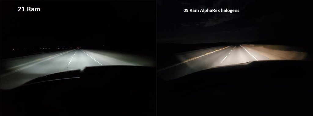

That set on the right has a beam pattern that's putting way too much light in other drivers faces.
No one has flashed me yet and it's looks like the same pattern as my '21 2500. It also has a cleaner cutoff line than my 2500.
