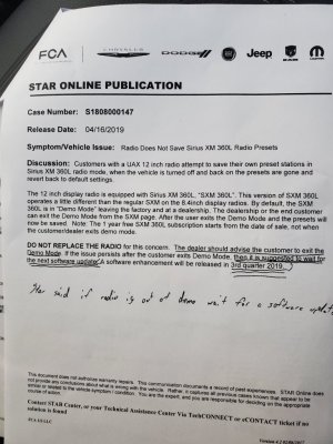

My 12" screen worked great for 2 weeks then just started to lose my presets. Spent 2 hours at the dealer, they couldn't solve it and supposedly reset it to factory to see if that solved the problem but I don't think he did because all of my custom settings were still there except Sirius presets.
There is a 3rd quarter update coming are we are in the 3rd quarter now so it could be any day. Hopefully that solves it.
I uploaded the letter for y'all that may have issues also.
