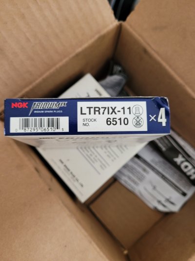

2016 Ram 1500 5.7L here, FBO mods with custom tune. Currently running NGK Iridium IX plugs. When is it time to run 1 step colder plugs, or that just for boosted applications? Thanks.

Unless you're boosted or running nitrous,the majority of tuners will reconmend staying with the stock plugs . I run Denso 3381's in my nitrous'd toy,as i'm not a huge fan of irridium plugs,i'd rather run a copper style plug,as it's way more efficient at transferring the spark ,then an irridium plug is,but the downside is they should be changed every 30,000 miles,which was no issue for me,as the truck got new plugs every season,and the Denso's were way cheaper then an irridium plug,lol.
What ever you do "Do Not" buy plugs off Amazon or Ebay,the majority of NGK's on both sites are fake knock-off plugs.

My other car is a VW GLI 2.0T, FBO stage 2. Definitely run colder plugs in that one.
