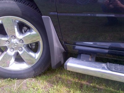

Hi All. Just wondering if anyone has any insight on installing oem mudguards with oem running boards. The mudguards on the front don't fit properly as they hit the running boards, this creates a gap along the side of the fender. Since both are oem I didn't think I'd have a problem. Is it possible to mount the running boards further towards the rear of the vehicle? Thanks

I'm not sure which running boards you have, but one member that had the ones that just go to the back of the rear door, switched sides and mount the right on the left and vice-versa and it solved the mudflap interference issue. This probably won't work if you have the ones that go all the way back to the front of the rear wheel well.

My running boards just cover the full length of the cab, I'm assuming I'd have to drill new holes if I swapped sides with the running boards? I thought of trying to soften the guards with a heat gun but can also see myself melting a hole in them too. lol

I had same issue the running boards hit my husky flaps. I flipped them from one side to the other.

I did flip my side steps from drivers to passenger side, this moved the steps back about 4". I have not purchased any mud flaps yet as I am still trying to decide if the truck looks aesthetically correct with them swapped. The other possibility is to elongate the slot from front to back to slightly move the side steps towards the rear.

So I swapped the drivers side running board for the passengers side and it worked perfect. It slid the running board back about 4" so now the mud guards fit a lot better

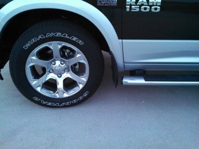

I'm just going by what the dealer said.. I was told OEM boards on the 13's were different?
Those actually look like different mudguards because you have the wheel well flares.

13 Crew with running boards & mud guards
Those side steps look like what they where putting on the 12's, look at how the slightly curl in at the front. And don't extend as far.
