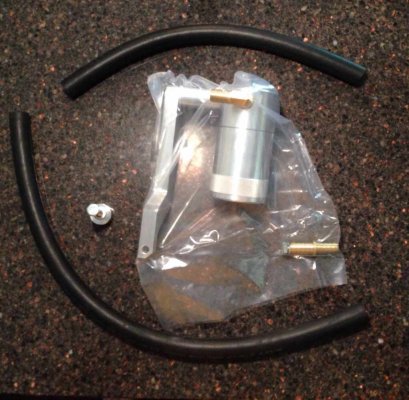

So, Thursday I ordered my catch can from Moes and to my amazement, it was sitting on the porch this afternoon, so I set out to install it. 10 minutes later I was done!
I found that I didn't need the spacer it comes with. I'm not 100% sure what it's for, but I have no clearance issues. I actually prefer it without so I didn't use it.
This catch can is awesome, but the bracket is even more impressive IMO. Well worth the 134 bucks.

Glad you like it. We include the spacer because there were a few trucks that had the can touching the wire loom that runs in front of the valve cover. It is no problem, but it would leave very fine scuff marks on the can when you would unscrew it. If yours isn't touching, then I would just leave it as is.

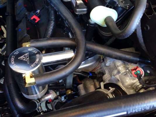

Yeah, mine may be slightly touching the wire loom, but it's got the corrugated plastic covering over it, and if it scratches the can on the back side where no one can see it, I don't care.
Thanks!

Are the tubes supposed to be crossed like that or does it matter which nipple they are put on. In other words, is the flow directional or not? My guess is no its not directional.

It is ok for them to be crossed. The inside of the catch can is not directional, so it doesn't matter which hose goes to the front or back. I personally think it looks a little cleaner with the front hose going straight to the TB, and the rear hose going to the back of the manifold.

The pipes wanted to go the way I put them on and since it's not a show truck, I could care less. I put them on the way that seemed more natural for the hose.
