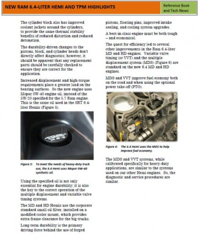

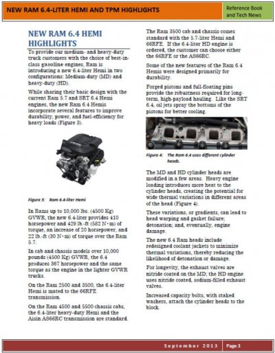

The 6.4 is a better built motor for HD work. Doesn't mean the 5.7 won't survive but it's not simply a matter of displacement. FYI, all gasser models come with the 66RFE, 68RFE is only used in the Cummins models.
6.4 liter Hemi truck engines for Ram pickups and chassis cabs
