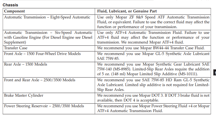

I was doing some research in this forum on the fluids/capacities for both differentials and the transfer case on my 2020 1500 Classic Warlock with 3.21 gears. I had the following in my carts:
Front differential: Redline 75W85
Transfer case: Amsoil MV (I have the BW 44-45)
Rear differential: Redline 75W140
I double checked my owner's manual, and Chrysler is recommending 75W90 for the rear differential. In the 2018 owner's manual, they recommend 75W140. Has anything changed in the rear ends from 2018 to 2019-21 Classic that would explain the need for a different fluid?

You are correct, if I was you I don't know what I'd do, maybe follow the book. As long as you are staying with that brand, the 90 for the rear will give stout protection against many other 90 weights, makes it an easier decision?
Side note even though you see there dot 3 fluid it can be substituted with dot 4, always the better choice.

Fluid type won't matter. I'd match the rear axle fluid weights. But that's just me.
Frequent Heavy trailer towing would be a special consideration.

Thank you. I also was not able to find much info about the MS-A0160 spec recommendation for the rear. Both Amsoil and Redline did not state if their oils met that spec. I emailed Redline and a rep confirmed that it meets the standard.

Thanks! I keep a folder with all my receipts, since everything has been done by me except for warranty work. I ended up ordering all this for my 30k mile service:
Redline 75w85 for the front differential
Amsoil MV for the transfer case
Redline 75w90 for the rear differential
Wix air filter and oil filter
Pennzoil Ultra Platinum 5w20
I'll end up doing the transmission fluid/filter change closer to 50k miles.
