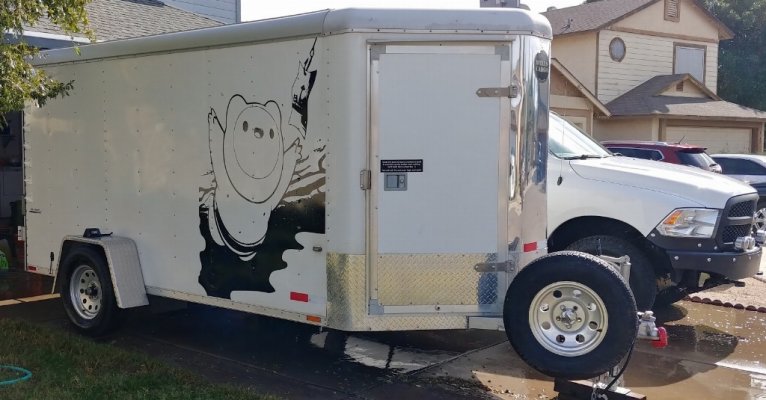

Wind is no joke, all I have is this little dingus and I feel every gust tryin' to make me seasick :(
