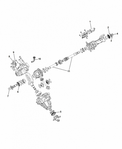

You'll probably not find many, if any at all, here using this setup.
The front axle and electronic axle engagement actuator are far from being the weak points in our trucks 4x4 system.
In 2wd, the passenger side front axle is decoupled. Effectively, split in half, by an electronic coupler.
As your driving, the driver side axle is rotating, Which rotates the spider gears inside the carrier. But, the carrier itself isn't effected.
So on the passenger side front axle, as your driving forward, the axle portion on the left side of the coupler will be spinning backwards and the half on the right side of the coupler would be spinning forward.
Basically, on the current setup, while in 2wd, the axles are freewheeling and the spider gears are spinning, but the carrier/ring/pinion are not.
It's not really very inefficient, so you probably won't find many who have bothered to use this kit.
Part# 11 is the r/s axle halves. The part between them is the sliding coupler.

that is some very good information, was wondering what that solenoid on the passenger side axle was for. so what you are saying is when in 2wd, the front carrier assy is not turning the front drive shaft ( or very little at most ) so there is not as much drag as it would appear. I guess the main advantage of a set of hubs would be less wear on the front CV joints. so what you are saying is that one would not really notice any or very little difference in gas mileage or front tire wear by adding hubs? that exploded view does help explain a lot on the system.
Ken226
Mar 12, 2017
2,285
5,904
Washington State
Right. Theres little to no parasitic hydraulic drag from the differential carrier.
There is a small amount from the spider gears spinning though. The axles are spinning, and the spider gears inside the carrier are spinning, so there is a little parasitic drag from that. But, its not a significant amount.
With regard to the locking hub kit, sure, it would be of some benefit. The question is, -is the juice worth the squeeze?-
It's 1600 ish dollars and at least a few hours of work, to increase the lifespan of a part that already tends to outlast the rest of the truck, and might gain you a fraction of a mpg.
