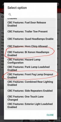

Check these settings
Some times the fog light drop out will effect high beam function.

I tried those settings, with the BiXenon and fogs dropout enabled, it makes the lows a bit brighter, still get the high beam outage. I also tried each with the other disabled also.
The errors I get are B1632 and B1636.
Any other suggestions? Is there a harness I can get that would help?
