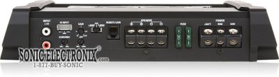

Got everything hooked up and it's all working and sounds alright, but I don't think it's performing as it should. I'm trying to figure out if I don't have it wired correctly or if I am going to need a different sub. I didn't realize until yesterday that I bought a dual voice coil sub, so I had to bridge it.
The amp I have is a MTX x500D: (picture attached)
Amplifier Class: D
Number of Channels: 1 - Mono
Total Peak Power Output: 1500 watts
Total RMS Power Output: 500 watts
Right now I have it wires just like the picture attached, one (+) and one (-) running off the amp to the box. I have these running to the sub on opposite (+)'s and (-)'s and then have the subwoofer bridged with a wire from the other (+) to the other (-).
Is this how it should be wired?
If not, what do I need to do to get optimal performance?
If so, what type of specs should I be looking for on a new subwoofer that will work well with this amp?
Thanks for the help guys!
