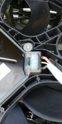

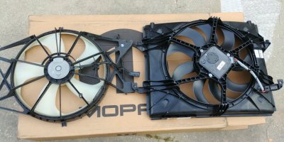

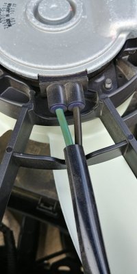

So after reading all the efan threads. I went ahead and ordered one part number 52014772AF from a 15-16 3.6l. My truck is a '17 so that is the latest part number closest to my year I can find. It doesn't look much different than my a/c fan. See the pic comparison below. The connector reaches to the original spot and the fan slides right in. However the plugs are different see the pictures below. It looks like this fan has a high and a low since it has 3 wires. So now I am not sure what I want to do. I am about to go reread some of the threads to see if I can fix my problem somehow. Any help would be greatly appreciated.
New fan plug:
My plug on the harness
New fan wires:
My fan wires:
AC fan and new efan side by side.

What did you end up doing? Looks like you got the wrong fan and should have gotten a fan from an older 3.7, not 3.6
