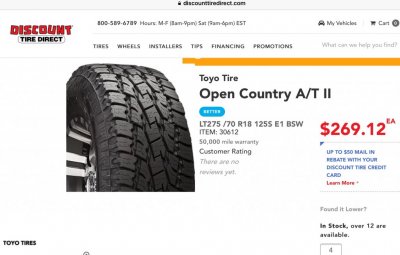

These are the tires that I am thinking of going with.
That tire is too small for a 2" level IMO, heck you could put a lowering kit and run that tire, its only 32" tall
The stock 20's are 1" taller than those at 275/60R20

I was thinking the same. 275 70-18 would be the same height as the stock 20s at 33" and are a common size. For some reason the standard 20's are 33", but the off road package are 275 55-20 32" on the 5th gen. Can't argue with the Toyos though. Great tires.
