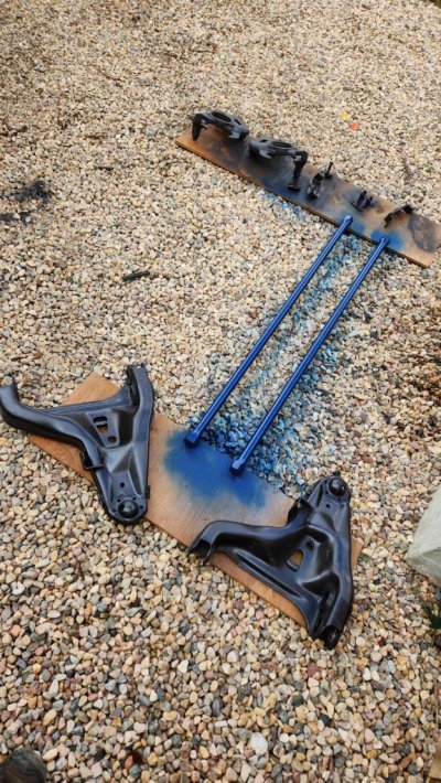

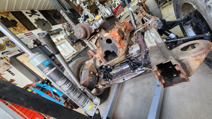

What a sh!tShow, At least it came off in 1 piece...lol...
ended up drilling out the torsion keys to get this appart...lol.. and lots of heat.
Saved a good chunk of change re-using the torsion bars and lower tabs so the fight was worth it.

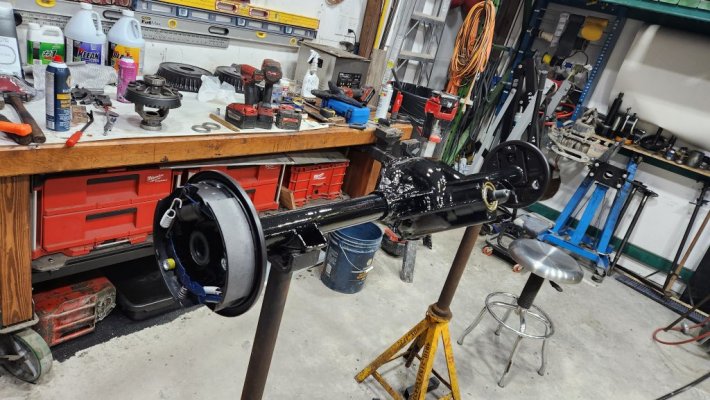

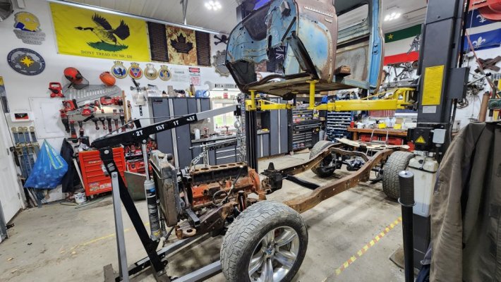

Blowing it all apart once done. ;) Will get sand blasted.
Need all that new sh!te in there to set cab mounts. Still lots of frame mods to do as well. And tons of welding.
Only Rust Ill have once done is the entire body... hahahahahaha

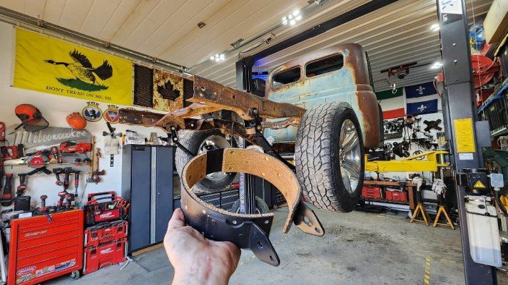

SIF in Edmonton did an awesome job rebuilding my parking brake.

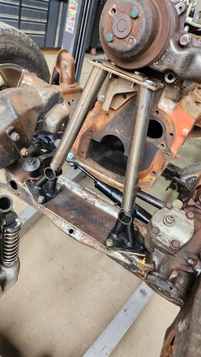

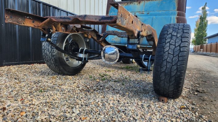

After a dozen cardboard templates, I present to you my front motor mounts...
Now Im prototyping the engine mount bars, I think this will be good.
BTW the SD220 is front mounted and there's no side mount bolt holes to tie into. and the rear mount is the bell housing.

That was the way they did things back in the early days.If you look at an early Tri-5 Chevy with the early 265 smallblock,it was even mounted off the front and the bellhousing

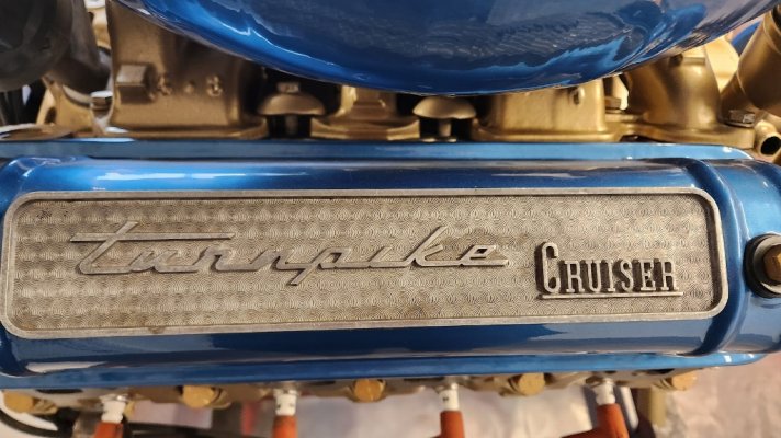

Talking about old engines. This was at the machine shop entrance. Doesn't get any rare then this. Serial #15
