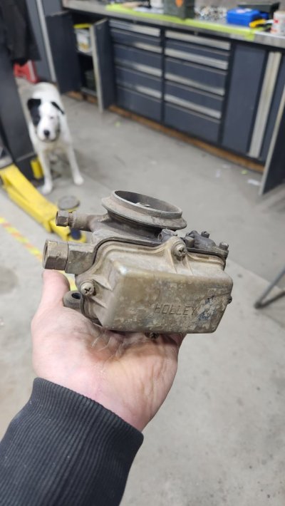

The holy grail of carbs for IHCs, and the one you want for a turbo set-up!
Traded it for my spare heater, still in shock buddy said it's a fair trade when both parties get something they need... Love these old school guys!!!

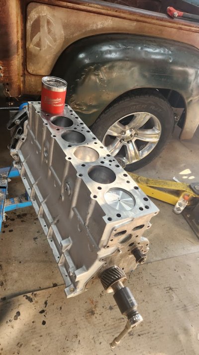

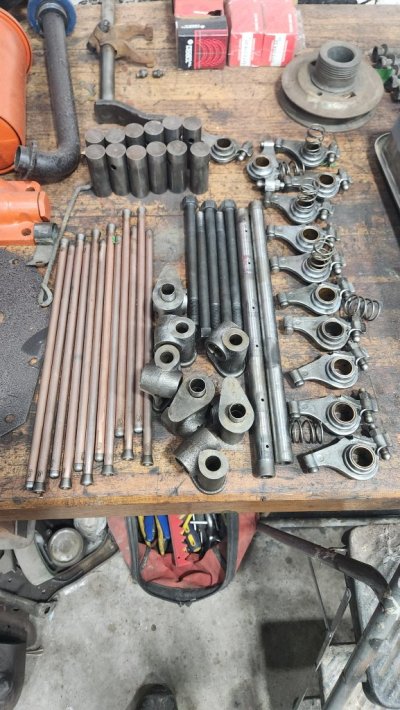

Test fitted the head, mocked up the rocker shafts and everything seems good.
Will throw everything back into the ultrasonic cleaner one last time before final assembly.
Im having a hard time understanding why a 1950s motor has better oiling system than the HEMI... *****.

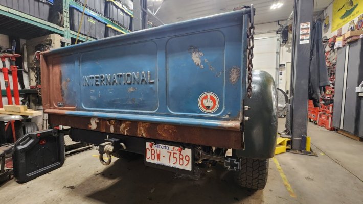

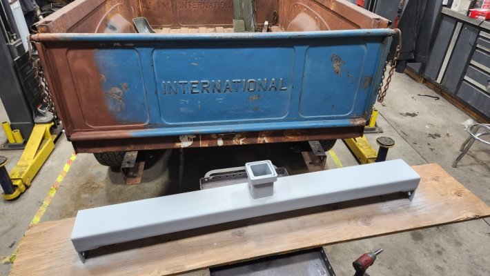

Didn't feel like paying for a receiver hitch. Amazon warehouse deals didn't have any either, and a new one is like 200$ .. lol
So the scrap pile came to the rescue.

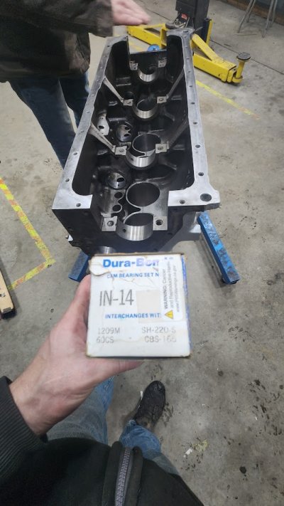

International Dealer in town called me today. :p
Cam Bearings are finally installed :driver: , perfect timing as im done the box. and got all my parts in for the rear lights.

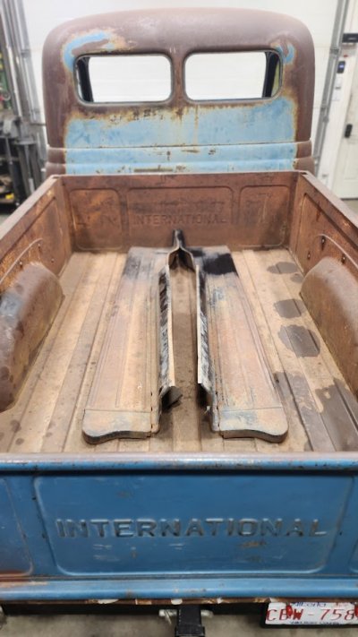

Well today sucked. Cant do the Bed mounted gas tanks like I wanted. To much Fab work and time I just dont have.
So I ordered a new 15 gal Fuel cell from Jeggs.
