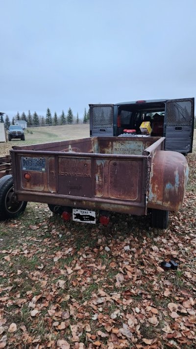

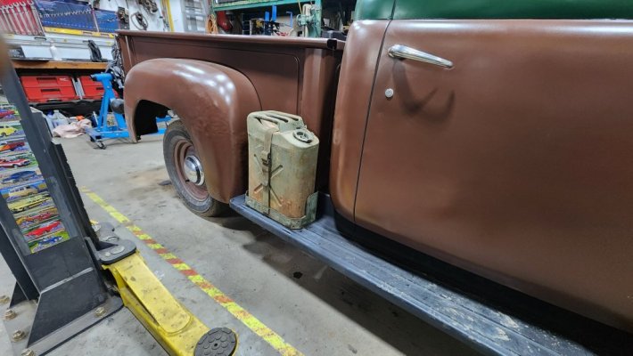

This guy just showed up from Texas to buy my ultra rare dually IHC box

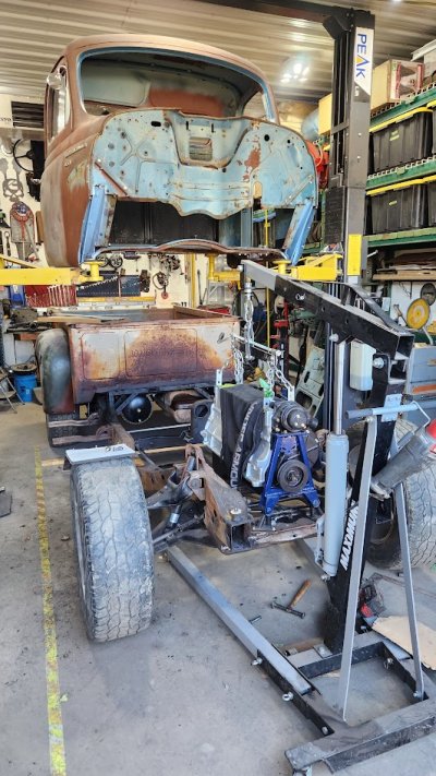

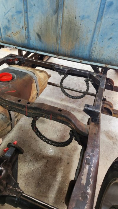

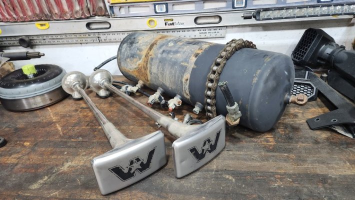

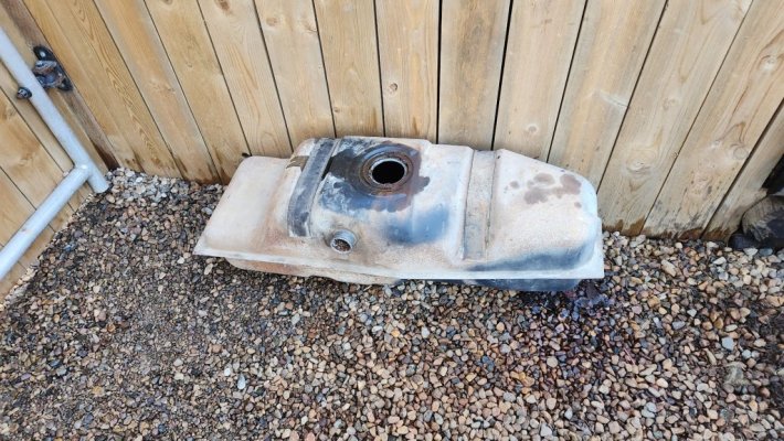

Chain is getting welded on the tank . No movement that way. LoL

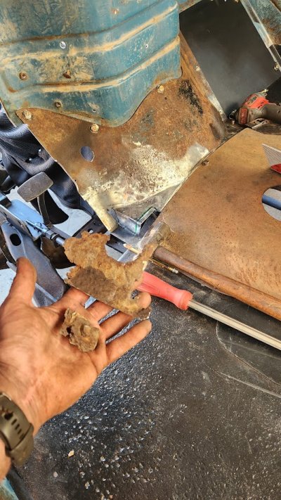

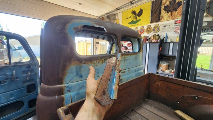

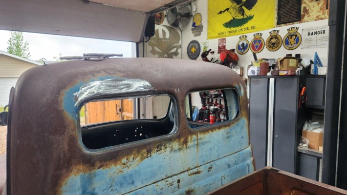

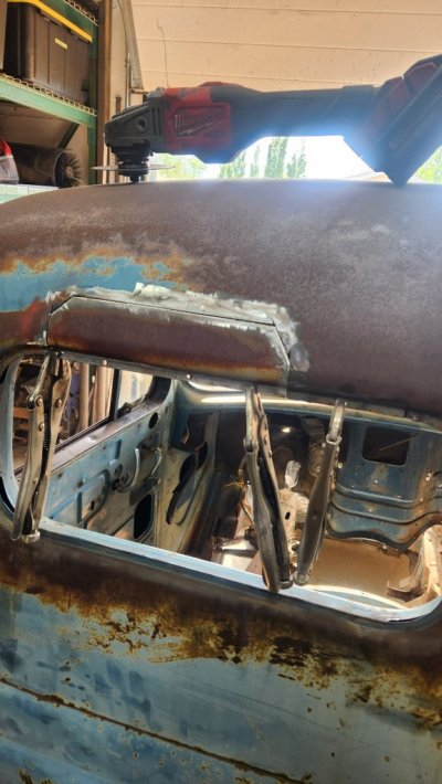

Been dealing with medical issues. And took a 3 week vacation.
Started dealing with the few rust spots caused by the mice nests that were allover this pig.
So glad I have a spare cab to get the missing metal from. There's no way in hell I could fab up therlse round pieces.

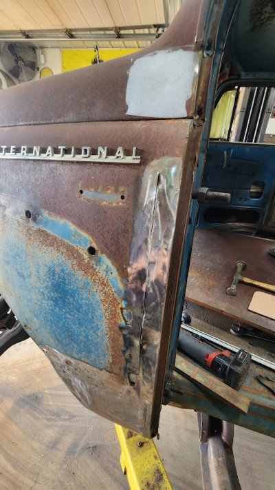

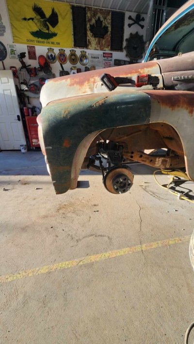

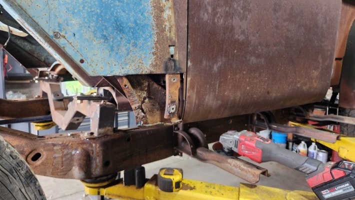

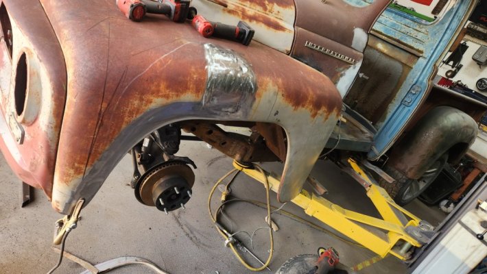

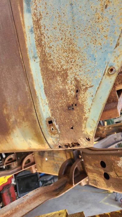

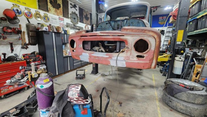

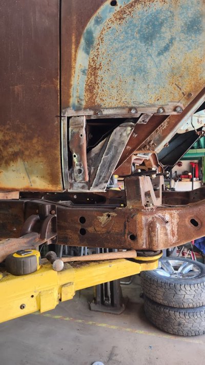

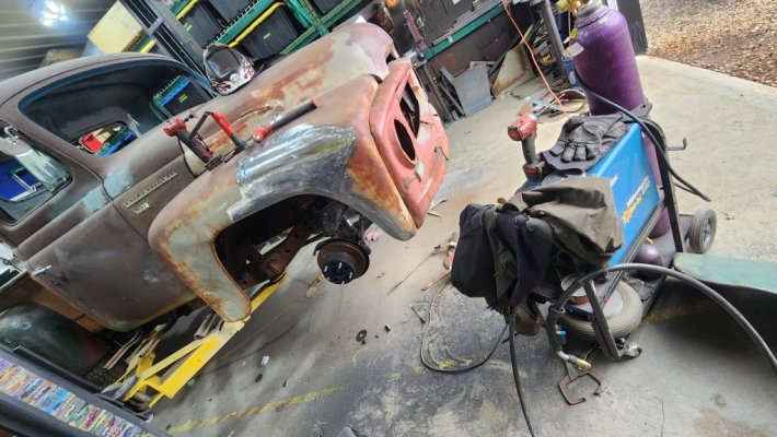

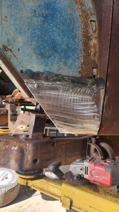

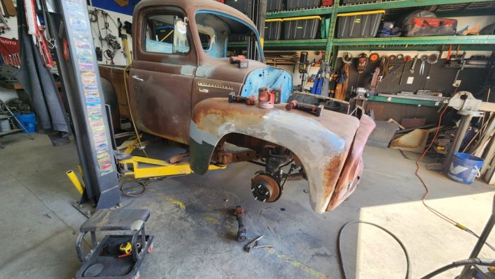

More hole fixing today, And fixed the huge 1" dent from the door stop being broken.
Both rockers were rusted thru. Had to rebuild the interior structure. That sucked all the ***** today.
Tomorrow is the front fenders, Need to move the wheel well hole forward 2" to clear the dodge wheels " lol. good thing I have a set of spares to cut up...

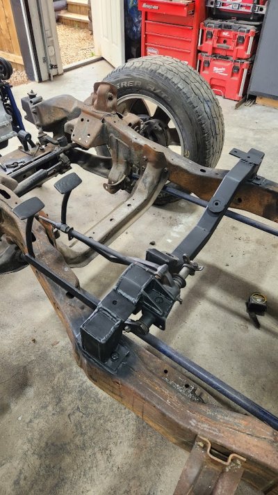

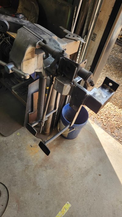

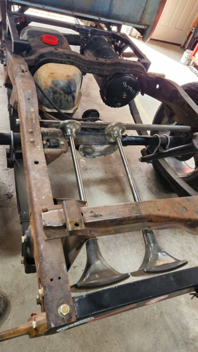

Fitting the original clutch and brake pedals is a PITA , Had to heavily modify my bell housing mount. Now I need to make a couple of gussets to tie it all back together.
