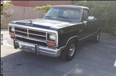

9619A55C-B264-4CB3-AB04-945DDFEA9305.jpeg Hey guys/gals,
New to the forum here! Excited about working on my truck, was wondering if anyone here has converted the tbi 318 to a carb. I’m guessing someone has. I’m seeing issues with my gas gauge and plan to trace the wiring but have a feeling it’s the dreaded sending unit which seems to be a nightmare. Just starting to form a plan, looking for input. I know the tbi has benefits but also looking for simple.. and def gonna take the truck in a muscle truck direction.. it’s a long term plan. Thanks in advance!

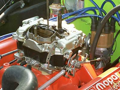

This was my "Muscle Truck" back in about 2005. I will tell you right now that I never concidered a 318 a powerful engine by any means but I had a 318 in this truck with a 4 speed and 3.55 gear. All I done to it was put the street Hemi grind cam in it, roller rockers, Mopar Performance ignition, headers and a Thermoquad carburetor on it. Before you go trashing the Thermoquad (I've heard the bad rap on them all my life) I am the only person I know who liked them. I knew how to adjust them to make them work. They definitely a PIA getting them right. The truck would run 14.5 quarter miles all day. Not a rocket by any stretch but would always surprise anyone that ask what size engine it had.
