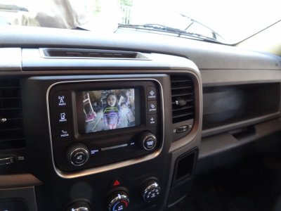

Here's a few photos from the rear. If it's flat and straight, you can see 50' or so.
The grassy photo is in full sunlight shining into the camera of the front lawn and woods.
I am happy with it.

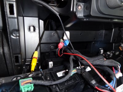

Installed my Echo Master back up camera. Picture is plenty nice too me! I followed Nburd pics and it was easy. I did have a problem with the signal pins pulling out of the connector at the radio but once I reset them all good!

I have a few problems. The first is I had my radio flashed and have everything hooked up but all I have is a blue screen. Secondly all my buttons now don't work in radio with the exception of the power button. What is the black and red wire on the back end of vehicle with the terminal lug on it for? The wire that runs from the camera mini 4 pin to the front off the vehicle. Is that the wire to turn off the lines? Is that a ground? Does our hook up to the reverse light? It is currently not hooked up to anythingWhen I hooked up the wiring harness I disconnected the negative lead as a precaution to make sure I would not cook anything. Any ideas would b be much appreciated.
Play2win
Mar 24, 2014
I have a few problems. The first is I had my radio flashed and have everything hooked up but all I have is a blue screen. Secondly all my buttons now don't work in radio with the exception of the power button. What is the black and red wire on the back end of vehicle with the terminal lug on it for? The wire that runs from the camera mini 4 pin to the front off the vehicle. Is that the wire to turn off the lines? Is that a ground? Does our hook up to the reverse light? It is currently not hooked up to anything when I hooked up the wiring harness I disconnected the negative lead as a precaution to make sure I would not cook anything. Any ideas would b be much appreciated.
I have since been able to get the camera to work. I had 2 problems that were causing the camera not to work. First off I didn't have the chassis ground hooked up and secondly the scotchlocks that I was using never perforated the wire jacket. I however still have a couple of problems. First is The camera now stays on all the time after I put it in reverse. Thus when I am driving down the road the camera stays on. Secondly I still have the problem with the touch screen and buttons not working. The radio powers on and I can hear 1 local radio station but that's it. I have the camera powered off of a 12v cigarette lighter that is switched thus it shuts off when the vehicle is off. Any suggestions to any of the problems would be extremely helpful since I'm at a lose as how to proceed.
