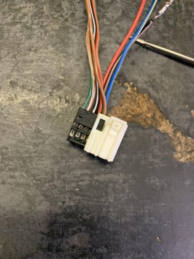

So my son installed his tow mirrors the other day. Mirrors look great and everything works. The only issue he ran into was the drivers side mirror the black plug had a 'guide' in the wrong place and the plug would not go in. He had to use a utility knife to trim that tab off. Anyone else have this issue? Everything works fine and it only took him a few minutes for the modification. The passenger side plugs worked fine.
I will probably be buying a set soon so was curious if this is a 'normal' issue or an anomaly?

The most recent set of trail ridges that I bought were like this. I just swapped the black connector covers from my previous mirrors to the new mirrors. The connector covers just slide off the connector sideways. Here’s a pic I have of the white one for an example- dTD8lrI.jpg

Thanks. Good to know. Only problem then is selling the old mirrors then you have to disclose that the plug needs modified, which will scare many potential buyers away. No big issue like this. I will just trim away the piece like my son did when I get mine.

I just installed them on the spousal unit's 2014, and I had to trim down the key as well. I'm guessing they just had a batch go out with the wrong plug cap.

I had to trim the tab off too. No big deal, took 20 seconds.

I had to trim down the tab on the passenger side of mine. 30 seconds with a utility knife.

yep. my son's had the wrong plug but 30 seconds with a utility knife and it was fixed. mine was fine. he actually got his mirrors about 2 months ago but didn't get to put them on until about a week or so ago so his were probably made/assembled awhile before mine
