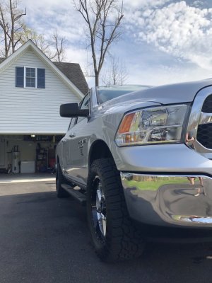

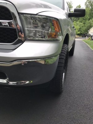

Its very possible. I am leveled with Bilstein’s and am running 305/55/20 on a 20x9 wheel with +18mm offset. Stock offset is +19 mm. That tire size would get you quite a bit wider over stock and its a 33.2” tall tire vs stock 33”.

Good info! Happen to have a picture? What brand tire you go with?

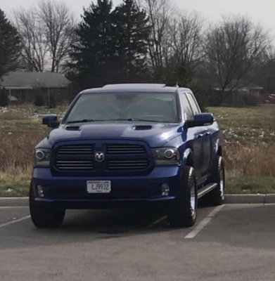

9" wide -12 offset are perfect for factory flares. 10 wide -24 will separate the men from the boys though. Anything wider is just looking for paint chips and attention.
Keep in mind these tires run 13” wide so they peek a little further out.

Love that color and stance Tim! So you have different rims then I’m assuming to accommodate those tires. I don’t have factory flares though I had them put on.
Thanks and yes, they are OEM 2500 flares I installed with color match by a mopar cert. painter. Moto Metal mo962 wheels, take a look at custom offset’s gallery if you want to see a plethora of wheel/tire/lift combos. You can run a taller wider tire on the OEM sport wheels since they are 9” wide +18 offset, but may need to use a spacer with 12.5”+ wide tires.

They would prob just meet the edge of the flare. Tires poke out right about 3/8 - 1/2” past fender. That size will get you about the max width you will want. I have a slight rub on the trackbar, both sides at full lock. But it is very minimal.

Wow those look solid! Slight rub, think that would be solved if was lifted 2”? Trying to avoid any rub. Thanks!

Im on bilsteins at 2.1 which equalled 2.5 or so inches in front and 1.5” coil spacer in rear. So technically I m lifted higher than you considering. The rub comes from width of tire regardless of the lift. These tires on a zero offset rim wouldnt touch.
