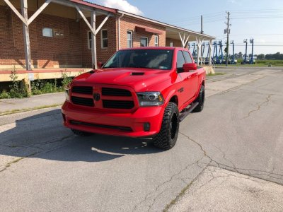

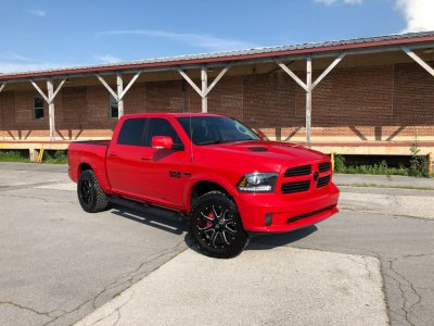

Just a picture for reference, here is my truck with bilsteins at 2.1 and 295/60/20 tires. For me they are a great size for just leveling. 295/65/20 would look rather stuffed.
91F416CE-6C1E-4098-A566-11A5C372A6E8.jpeg 933178C6-4BB1-4D4D-934D-5B6635F13B3E.jpeg 71D6B543-670F-4F75-9F1C-7E8C2750C4BC.jpeg

That’s what I’m saying. Your wheels have a +19mm offset, a 20x9 with -12mm offset is a difference of 1.25”
And I agree to get the look you are after you will need new wheels or wheels spacers

Love those aggressive tires. Yea I can see them being stuffed..
Oh, he told me there’s no offset on stock wheels it was 0, but guess there’s positive offset to bring it inward?
Not gonna do spacers due to the downsides. Sheesh just when I thought I was getting somewhere hah, so seems like it’s gonna need to be: lift, rims, tires. Wow that won’t be cheap.. Could prob get away with selling my old rims or tires. Was hoping to do 2 out of the 3 things but seems like it’s almost gotta be all or nothing.

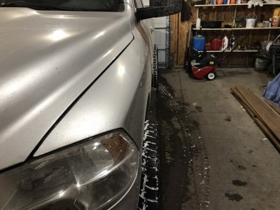

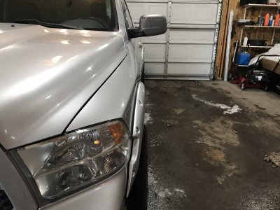

I’m running 5100’s set @ 2.8 with 295/60R20 on 20x10 rims with a -25 offset. The tire stick out exactly 2” from the fender which is perfect for the fender flares I bought.

Same fender flares I think! Yea, so that's seeming like the specs I need. That sucks to need new rims for 1"... No rub?
