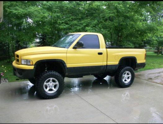

olyelr
Nov 18, 2018
5,563
4,586
Kewadin MI
I will try to find a pic of that old yellow truck when i had 35x12.5’s on those wheels. They looked good.
