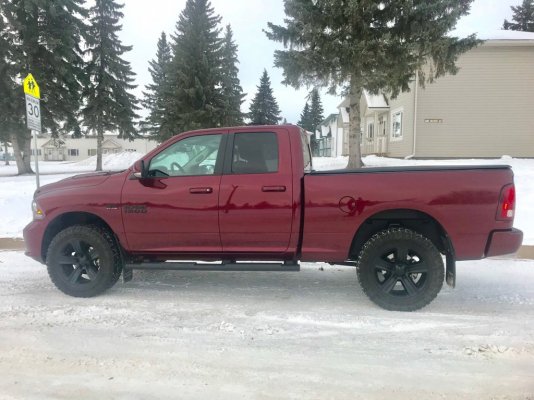

Very similar measurements on mine before I did them last week. Went 2.8 and I wanted rear spacers so I put readylift 1.5s in as I don’t mind the rake. Sometimes I have a little Weight in the rear but rarely tow anything.
After mine installed I got this look. Did the alignment 3 days after install and I have had zero death wobble in 4x4 Lock at high speeds. Smooth as before. If I went 2.1 I would have been disappointed because the 2.8 just barely clears my 34s. Not enough to fit 35s without rubbing again.

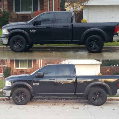

Before and after. Went with 2.1 and it was perfect. Less than 1/2" of rake. 071af133003006e9b0c073cdda9dd654.jpg
