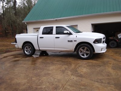

Running a 295/35/24 now but all my measurements were off the stock20's
Before and after pics
