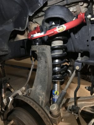

Get the Bilstein 5100's ....several others on this forum have used them (myself included) with outstanding results.
When i installed the Bilsteins i went ahead and installed some new Ready Lift UCA's to avoid any issues with the OEM ball joints. ALOT of people have installed the Bilsteins without having to replace the UCAs, but i wanted to be proactive.

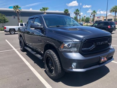

I went with the Bilsteins set at 2.8 and am very happy with the stance and the ride. The photo was taken the day of the install so I expect the front to settle a little...
