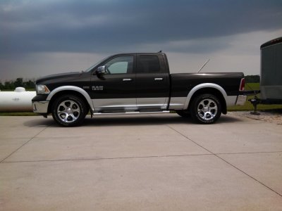

Like the title says.. Everything went together very easy and I did the install by myself in our driveway. Well, our 4 yr old daughter cheered me on at times. Lol. Excellent products and good directions. Had the truck aligned today and the shop had no issues. I have not noticed any difference in the way the truck rides or drives. No vibrations whatsoever in 2wd or 4wd under acceleration.

After

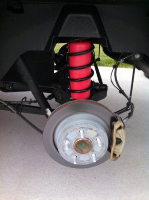

The rear measures about 3/4" higher than the front. The below pic is the rear end suspended and the bags in place.
