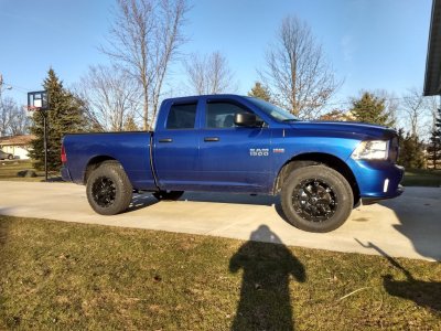

I just put 1.51" tgc spacers on, and bils set at 2.8

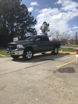

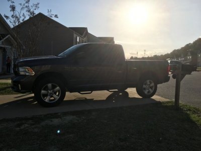

On my 14, I did Bils at 2.8 initially and found to be a touch nose high. I added a 3/4” rear spacer and I’m pretty much level, it looks like I have a little rake but overall what I was looking for.
I wish I would have gone 35s, there’s plenty of room in the wheel wells without being stuffed.

Bils set at 2.8 on mine with nothing in the rear. The rear still sits higher. Also have the zone 1.5 body running 37/12.5/20 nitto trail graps
