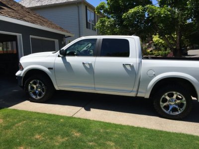

I'm new to the forum and had a question about leveling my 2015 ram 1500. I'm thinking about having les Shwab install a 2" front only leveling kit. My question is would it look weird with stock tire size? I put bf all terrain ko2 when I first bought it and I wanna wear them out first. Any thoughts?
Here is my 2015 with a 2.5inch MaxTrac level, stock size, with BFGKo2.
Get the Maxtrac as it avoids the ball joint issue with a two piece install.

Not all spacers. The Maxtrac system avoids this.
