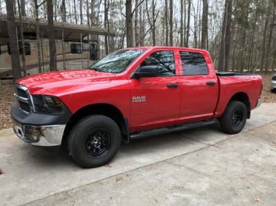

My 2016 2WD still has it's stock tires and it doesn't look "Too bad" with a 2" TGC leveling kit, Zone UCA's and Zone 1.5" body lift. I couldn't justify changing the tires yet seeing as they only have 6000 miles on them.
At some point I'll get bigger tire but for now I can deal with it.

I did bilstein 5100 set at 2.1. Hankook atms stock size 33". It cost me about 400 total with shocks, install and front alignment. It still rides great.
