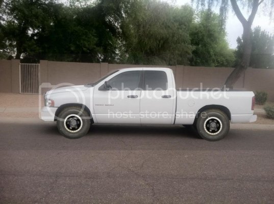

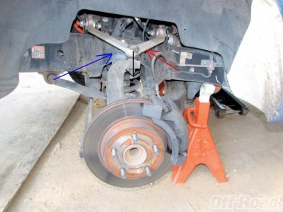

I am new to this forum, but not to trucks haha. Anyway I was installing my Daystar 2" leveling kit last night on my 2003 2WD ram and after putting the spacer in and jacking the lower control up to simulate weight, I realized that there was no safe way to leave that on the truck. The upper control arm was under an inch away from the coil bucket. The Rancho 5000's I got that were 2" longer to accommodate the lift allow for full travel however they did not stop the upper control arm from hitting the coil bucket.
Now I know a lot of people on here have leveling kits and I guess my question is, did anyone else notice this issue? I know reduced droop would happen since the spacer is simply raising the ride height but less then an inch of downward travel seems dangerous to me. I really wanted a spindle lift but only found Ebay with them and was worried about the quality of metal. Does anyone currently run these spindles? Are they decent? I heard Crown Suspensions out of cali offers a lift spindle as well and ATOMIC was supposed to have long travel.
Anyway I just wanted to share my story for something to think about for people who are thinking about doing this. With so many on the road you would think it is plug and play but there are things to consider. I ended up stopping the install the moment I saw this issue and put it back to stock. In my case the lift wasn't worth the damage to the upper control arm or worse.
