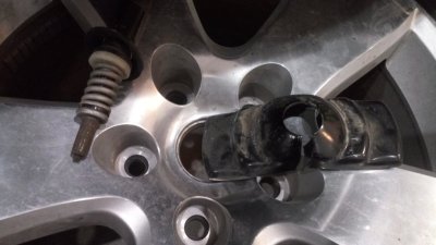

Interesting just went thru this, mine truck is a 2018 tradesman came with 17's I put Ram 20's on it I think from a warlock got a 20 ram spare. Anyway center hole was 2 small. I cut a slot in the bracket. That bracket is pretty heavy duty. I don't for see a strength issue.20in spare.jpg
