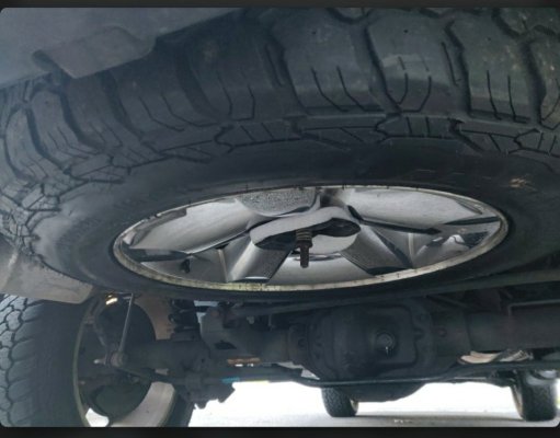

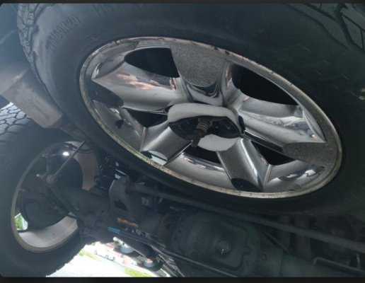

I did the same as Magfan2, bought a 3rd gen 1500's, 20" clad from the local parts yard. Did a simple mod to the wheel and now I have a some what matching full-size spare. I used a 70 mm hole saw to drill out the center, in order for the hanger to pass through.
