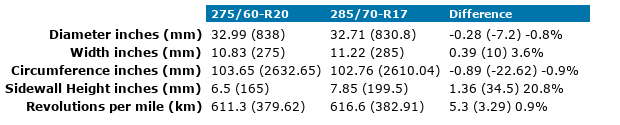

If you go with a larger diameter tire, it will effect the acceleration and how the truck shifts. You could get a V6 truck with 20" rims and 3.21 gearing from the factory.
A 285/70/17 is close enough for conversation sakes to the factory 275/60/20 diameter. It's also the stock tire size of the Ram Rebel, so if you don't want to tackle changing the speedometer with AlfaOBD (dealers can only choose factory sizes).
Your also right on the money about going with a larger tire on a 17" rim is usually less expensive and a larger selection than tires for a 20" rim

If you do go with 285/70/17's upgrade to the Rebel wheels or another 8" wheel, the stock 7" wide 17" wheel and that size tire really hurt handling around bends - did for me at least.

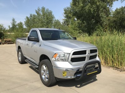

I had 295/60R20’s on my factory chrome clad wheels without any problems. My truck came with the 20” chrome clads from the factory.
