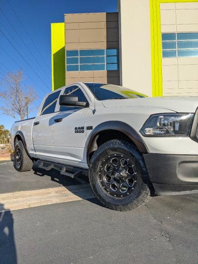

I went with fuel 18x9 (305/65/18) with Nitto's from stock 17's and Goodyear's. 2wd with 1.5" leveling spacers in front. No rub at anytime. I wanted to keep sidewall so that's why I didn't go 20's.553ce6b5c2412c9bf95db3df9b1386f5.jpg

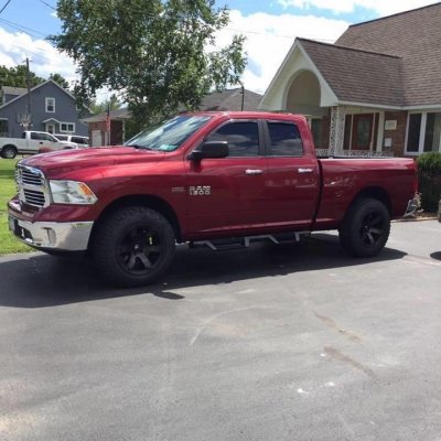

The inexpensive option is get 17x8" oem wheels from an older Ram and run 285/70r17 tires.

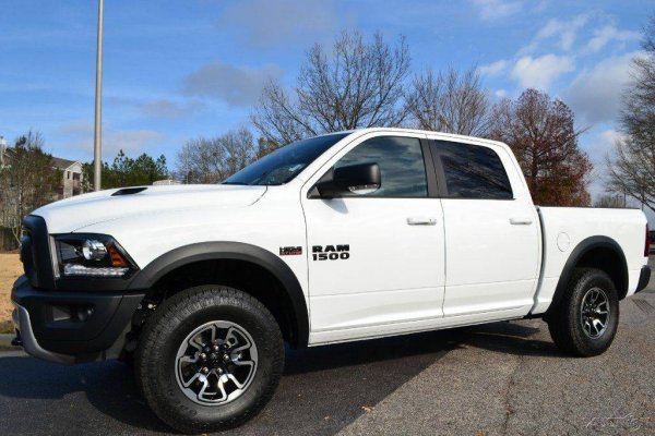

People are picking Ram Rebels 17" wheels. They came stock with 287/70/17
Size: 17x8 Lugs: 5 Bolt Pattern: 5.5 Inch Offset: 18.05mm
I have thought about that. Not a huge fan of the rebel rims myself. I suppose if I found some for the right price I'd go for it though.

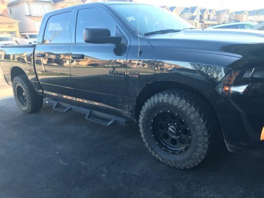

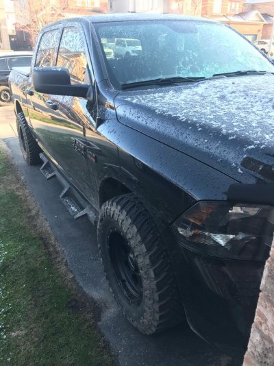

17x9 pro comp series 45. -6 offset.
33x12.5x17. No rubbing.
Stock height but will be installing my Bils at 2.1 and down the road a 1.5 body lift
